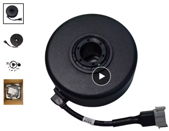

To order, the official link for the latest version of the steering wheel - direct from Keya themselves - is here. PLEASE NOTE: there are imitators on AliExpress selling Keya-lookalike motors. The link here is to their official shop. Please support Keya as they are known to work well, and we have great support from the manufacturer. Other motors are not always known to work correctly, and Keya cannot support them if you come to the channel asking for help.

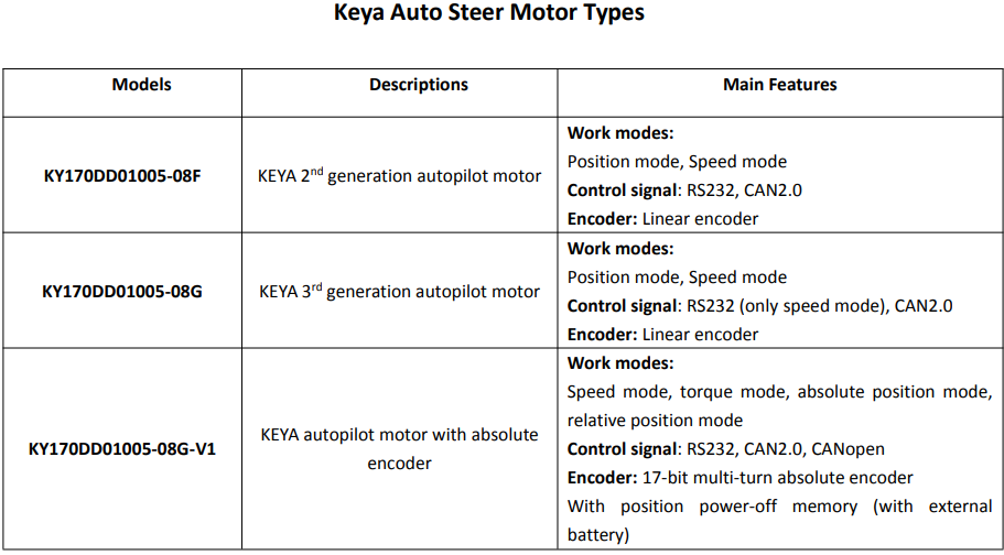

Keya reference manual: Keya KY170DD01005-08G v2.4.pdf
If you’re in Europe you might want to check navisklep.pl They’ll supply with the 3 spoked wheel.

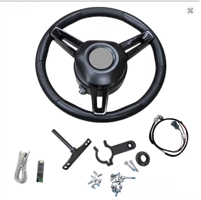

The full kit, gen4e motor or the dual-spoked wheel«« this is what you want

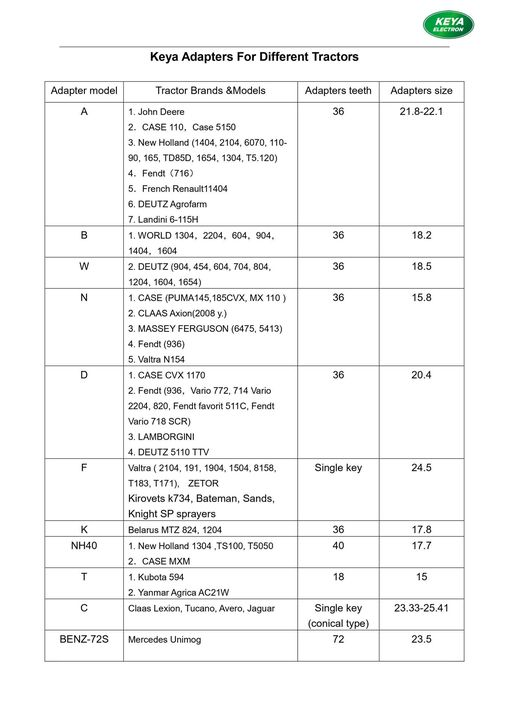

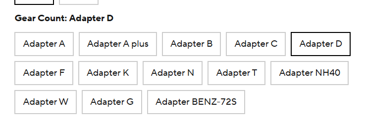

Remember to select the correct adapter when ordering! alt text
Additional parts
Just a steering wheel, no motor: https://www.aliexpress.com/item/1005006723020417.html
Adapter type A: https://www.aliexpress.com/item/1005006590788935.html
Adapter type D: https://www.aliexpress.com/item/1005006590913968.html
Adapter type F: https://www.aliexpress.com/item/1005006591675066.html
Adapter type N: https://www.aliexpress.com/item/1005006591480010.html
Adapter type NH40: https://www.aliexpress.com/item/1005006591353337.html

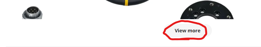

You need to specify when ordering which steering boss you require (and let them know if you require additional ones). Pay attention to the aliexpress link, the “View more” bit will list all the adapter types. NOTE: this list below might be out of date as more models are added, so look for this chart on the aliexpress link!!

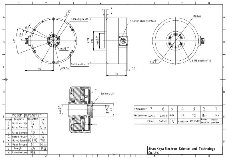

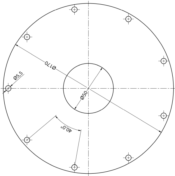

Download this Keya template, to help with marking out for brackets or this template for the new 1.4 motor.

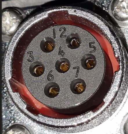

Connections:

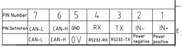

You’ll be powering 12V to pin 1, and GND to pin2 - and don’t power this through the AOG board! Put it on its own supply with a big huge “OFF!” switch for safety.
Pin 6 (CANH) goes to pin 16 on ampseal and pin 7 (CANL) goes to pin 17.

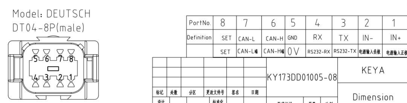

If you have the 4th gen motor that comes with the Deutsch connector, go by this instead:

Motor types

Known fittings
Note - you should ALWAYS measure the diameter and count the splines yourself. This is for reference only.
TypeTractor
ACase 5150
Case Puma 160
Deutz Agrofarm
John Deere 7x30, 6x30, 6300, 8300
Landini 6-115H
NH T5.120
A+NH TS125a
NH T6/T7
B
DDeutz 5110 TTV
Fendt 718 SCR, Favorit 511C
FBateman, Sands, Knight sprayers
K
NCase MX110
Claas Axion
Fendt 936
Massey Ferguson 5413
Case Magnum 310 2013
NH40NH T5050
TKubota B3400
