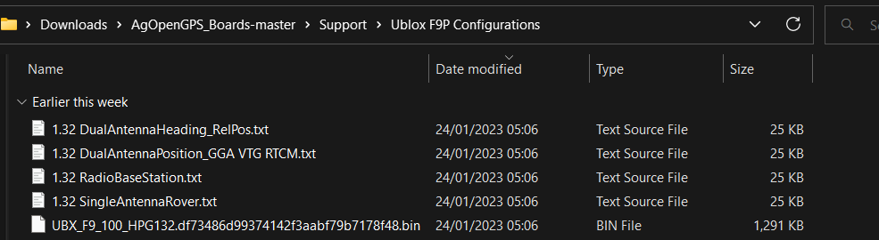

First, get the firmware and configuration files here, so go grab them (you can get them all in one zip file here.
Unzip them, the 4 text files are the configuration you upload to the F9Ps, and the .bin file is the firmware.

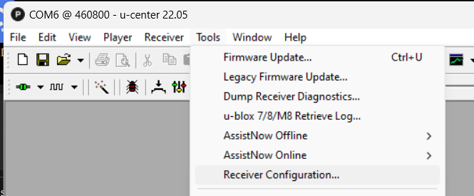

Open U-Center, and connect to your F9P (there should only be one) and it will
have picked a COM port number (this is why you do one at a time); In the top
left menus, find that COM port and pick a speed of 460800.

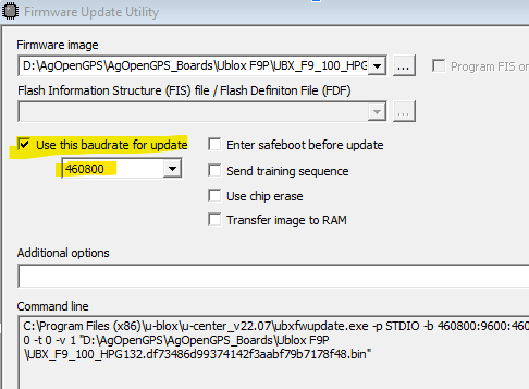

Tools -> Firmware Update
Choose Baud Rate of 460,000
Hit Go! at the bottom left wait a minute or two and if there’s no error message you’re good.

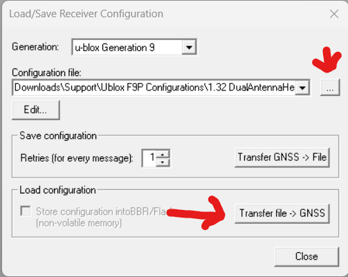

Section titled “Configuration details”Open Tools, Receiver Configuration,
and pick your file
- For single: 1.13 SingleAntennaRover.txt
- For dual left socket we need 1.13 DualAntennaHeading_RelPos-Left.txt
Then click “Transfer File -> GNSS”.

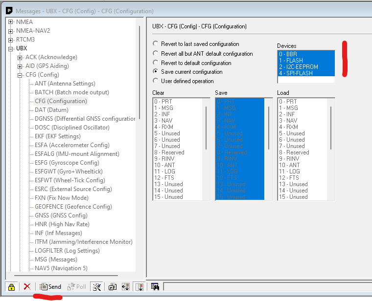

Once that’s done, go to Receiver -> Action -> Save Config and SAVE IT! Alternatively you can do View -> Messages View and SAVE IT! This will be the F9P that will end up in your left-hand socket.

Follow the same procedure and this time for Right receiver pick 1.13 DualAntennaPosition_GGA VTG RTCM-Right.txt This will be the F9P going in the right-hand socket.
As above, save.
