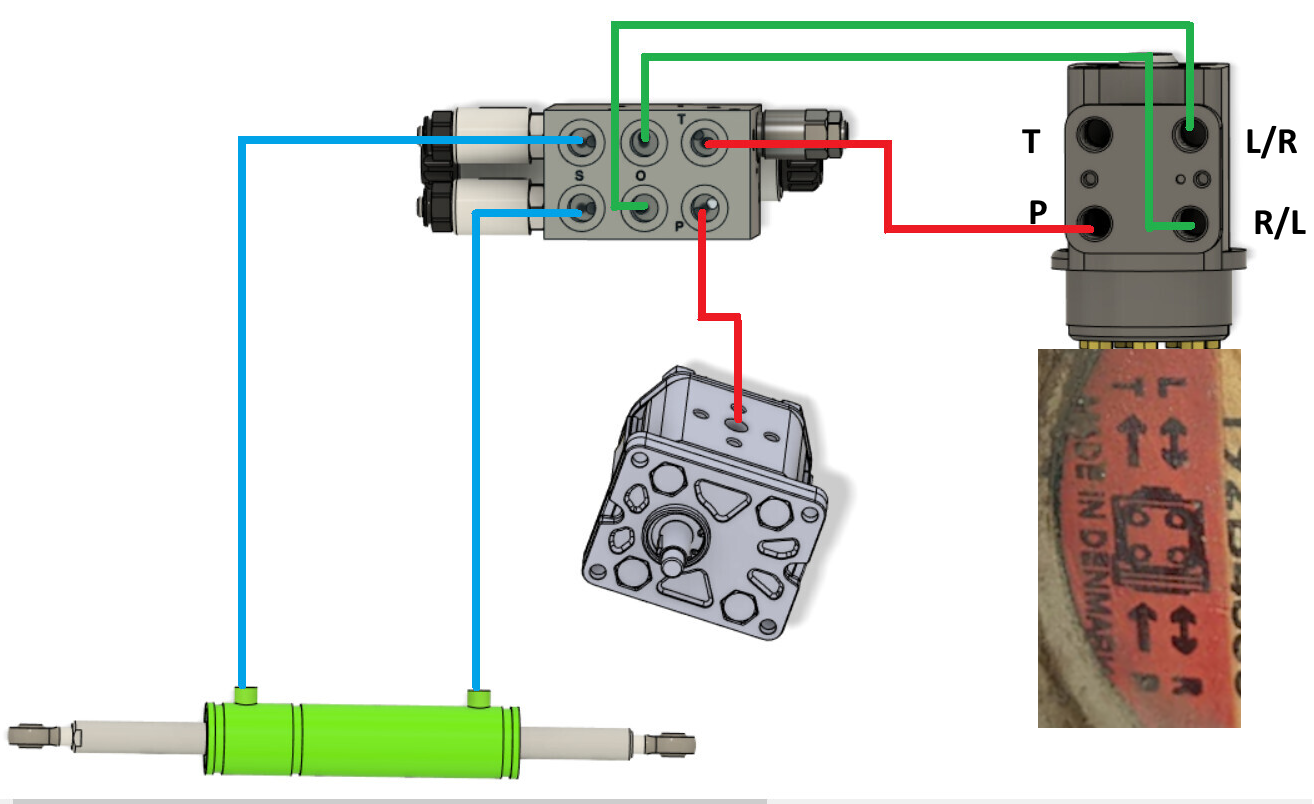

Take a look at your Orbitrol:

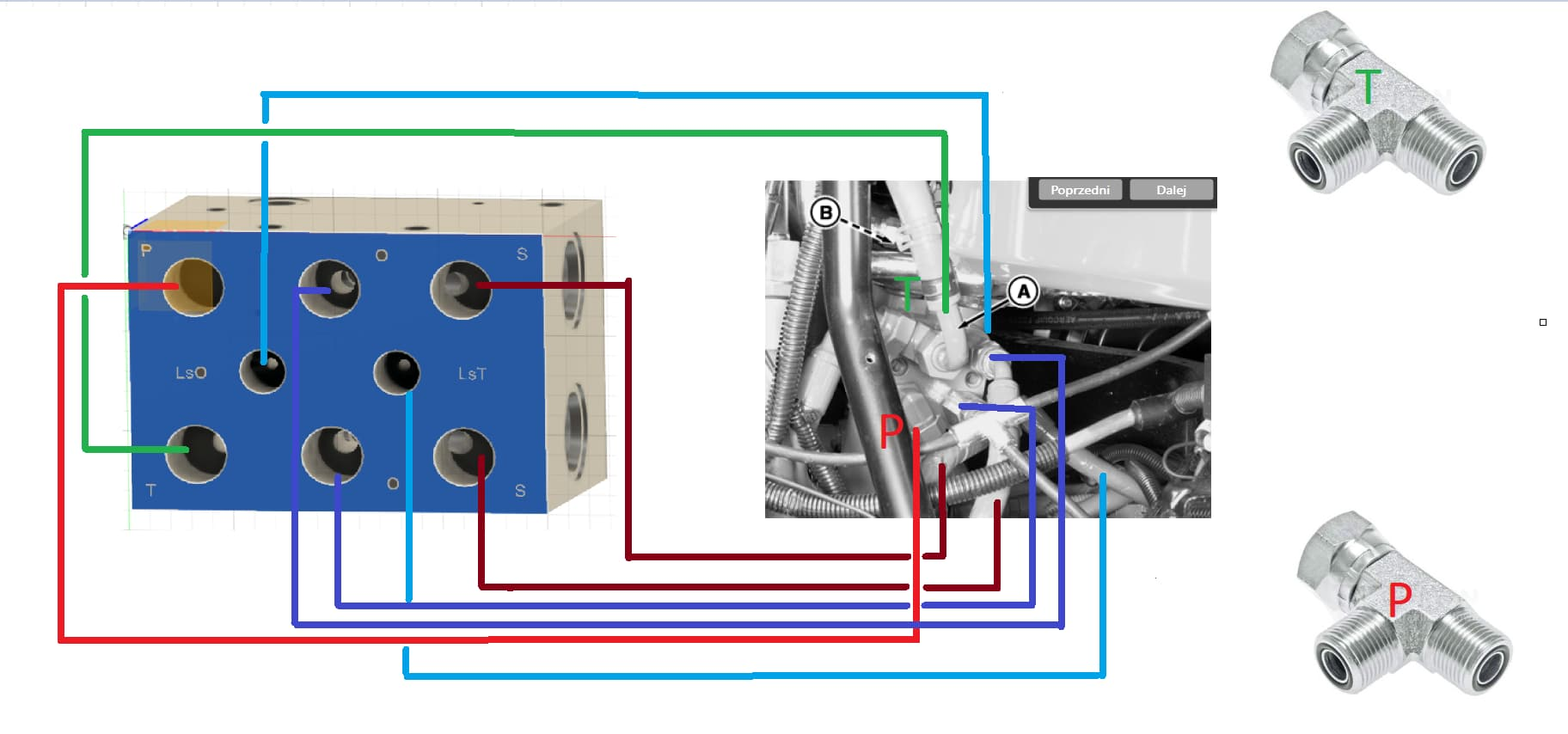

- 4 hoses then you’ll need an OC valve and will be connected between the pump / steer lines.
- 5 hoses will be an LS system and needs an LS valve with “Tee” connection and will be connected parallel to the P / T lines and between the LS / steer lines.

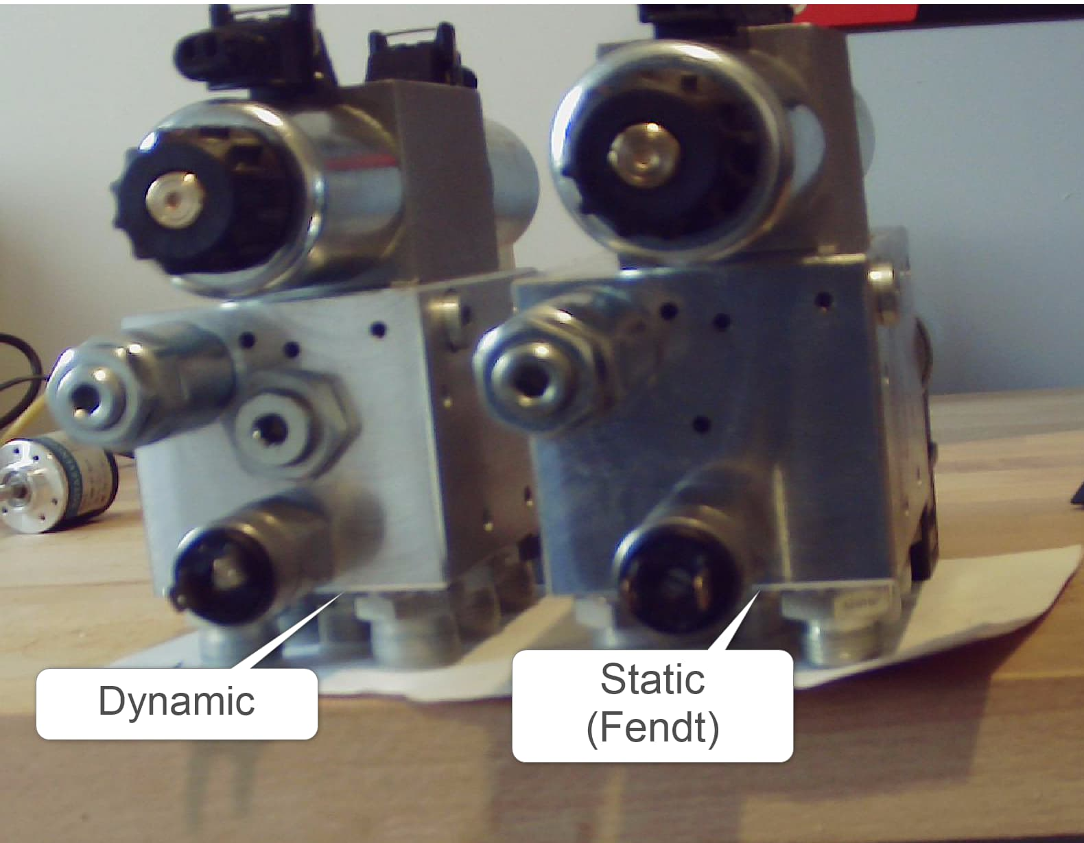

- !!! some of the tractors require special valves, for example:
- Fendt (static)
- John Deere 4XXX
- CASE Quadtrack (90L) require special valves !!! Double check on these.

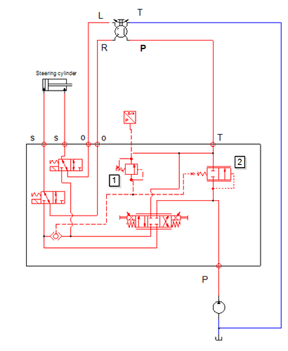

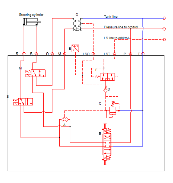

Engineering drawings: OC
Explanation: Credit goes to Commonrail
2 is a logic valve, it basically makes a small LS closed centre system inside this valve block for the autosteer. This valve will keep the P line a few bar higher than the internal LS line (in other words a few bar higher than what is needed to operate the wheels at the current time)
1 is a relief valve used to limit the maximum pressure for the steering, when this valve is tripped the LS line can’t go any higher and the valve 2 will let the oil out the T port
The pressure sensor is connected to the valve block T line, this line is connected to the P port of the orbital and because it is open centre the oil free flows to tank. But when you turn the steering wheel the pressure in this line rises as oil is needed to turn the wheels, because the orbital steering lines are blocked this pressure rises quickly and the sensor trips to tell autosteer to stop steering

Special valve for Fendt:

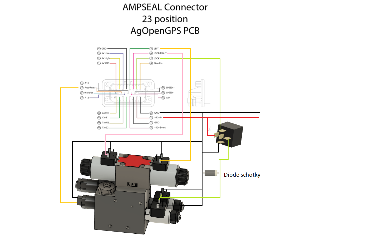

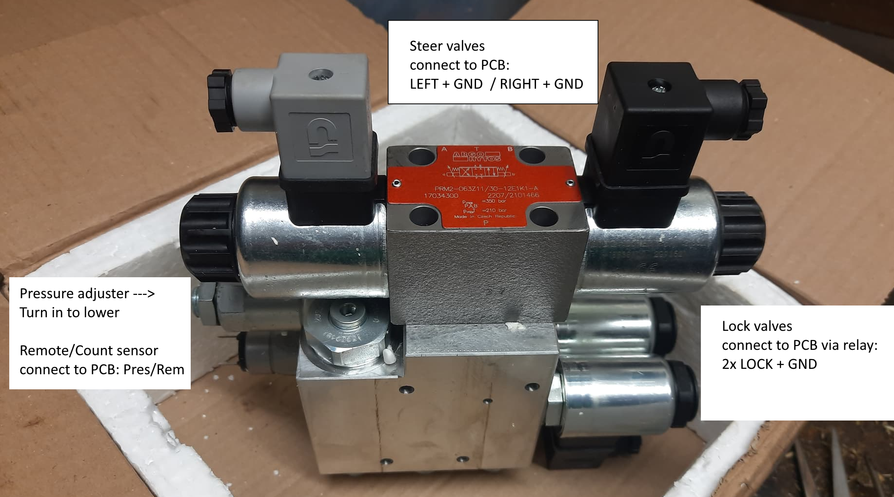

Electrical connection(s)
Theoretically the FET
should be capable to handle the power to lock the valve. In practice we’ve seen
smoke in some cases. Best practice is to add a relay controlled by the Lock pin.
There are 2 kind of “pressure” check valves:
Count type
The one with 2 pins needs to be connected between Ground and Pres/Rem connection. The sensor is a SUCO 166 416 0 31 063 NC
The PCB jumpers must be configured as Remote.
AgOpenGPS must be configured as “Turn sensor” with value as “1”. (it only clicks once)
Pressure type

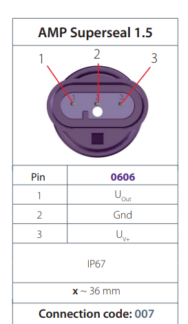

The one with 3 pins uses an AMP Superseal 3pn 1.5 connector and requires 5V from PCB (WAS 5V could be used).
The sensor is: 0606-25209-B-007 Pressure Transmitter 0 bar - 250 bar 0.5-4.5V Ratiometric NPT1/4 AMPSuperseal 1.5 17-4PH Stainless Steel Cell
The PCB jumpers must be configured as Pressure.
AgOpenGPS must be configured as Pressure with value accordingly.(~10% is equivalent as 0bar)
pinout is:
- pin1 -> signal
- pin2 -> GND
- pin3 -> 5V

Installation of LS valve
Installation of OC valve

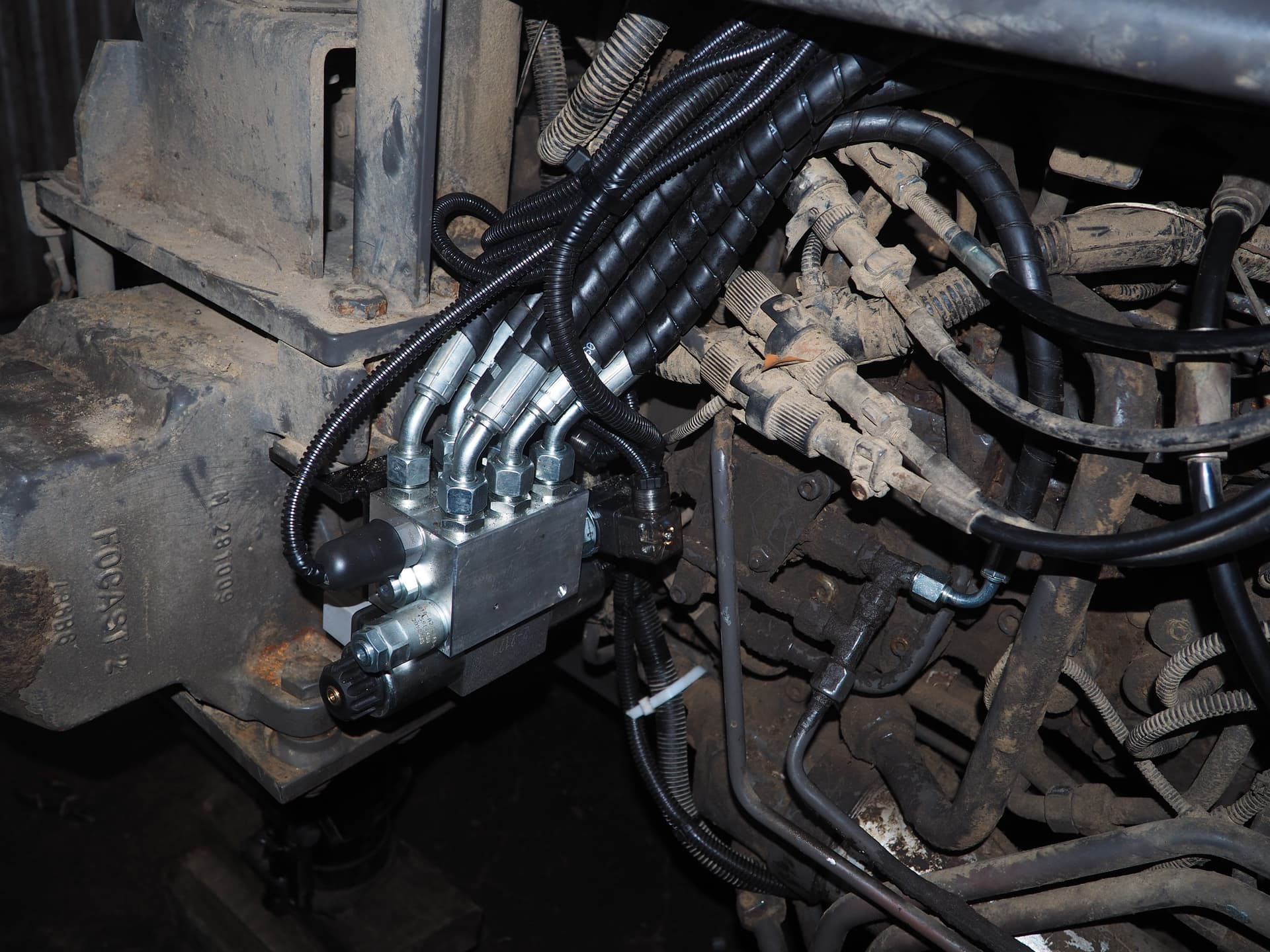

Installation example
Marek has a great set of pictures here for installation on a Massey 5445

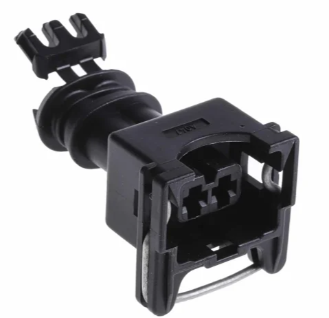

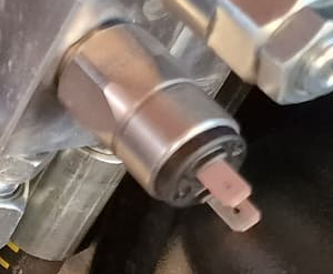

Plugs that are of use
If you have the two-pin plug for left/right solenoids, you can use these (TE part 718-6867) to connect:
https://uk.rs-online.com/web/p/automotive-connectors/7186867

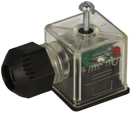

If you want to use 3-pin plugs for the lock valves that have the schotky diode built in, use these Molex part S28200TC310R):
https://www.kempstoncontrols.co.uk/S28200TC310R/Molex/sku/457859
