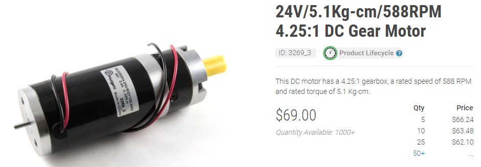

Phidgets 24V motor
If you’re going down the steering-wheel-motor route, the Phidgets is the one to buy. There are alternatives, but PotatoFarmer has made an excellent 3D-printed holder that fits it nicely (see below)
Specs: 24V 600RPM 5.1kgcm torque
https://www.phidgets.com/?tier=3&catid=19&pcid=16&prodid=993

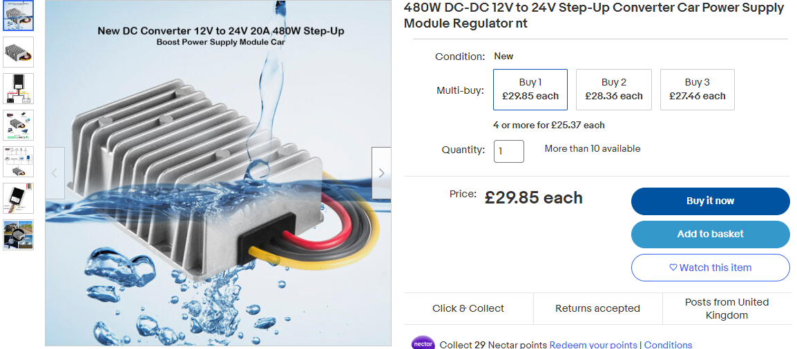

Note that if you’re using a 24V motor as above, you’ll need a 12V-24V step-up converter, sample here.
https://www.ebay.co.uk/itm/334688323208

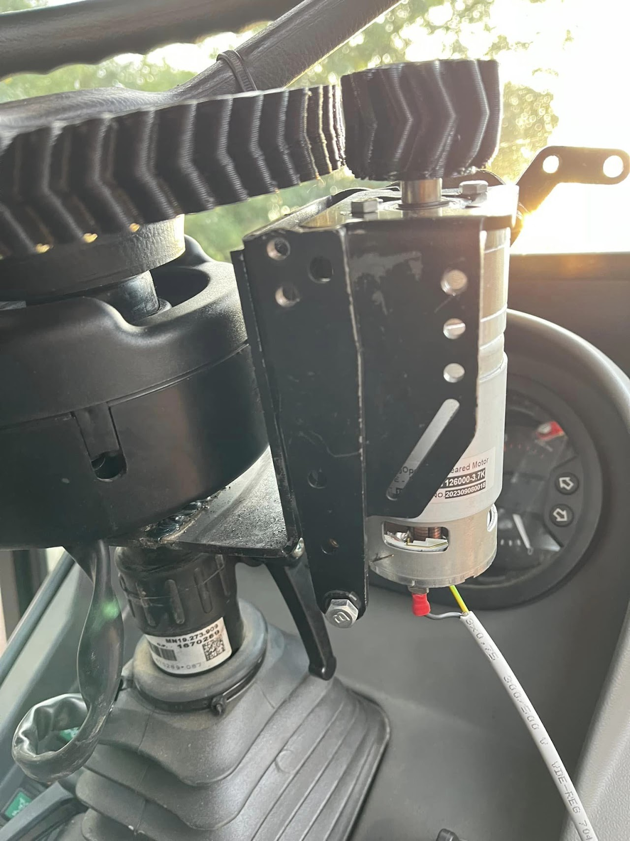

MFA 12V motor
This is mostly used by the French guys you can source it from a couple places in europe. You can get roughly a 30% discount from the manufacturer when directly ordering from them but you need to order 5+. https://www.mfacomodrills.com/gearboxes/986d_series.html
Specs: 4:1 ratio 12V 1300RPM 3.3kgcm
(you can likely add an extra 10% as the tractors voltage is around 13-14V) which makes this less powerful than phidgets but good enough for U-Turn
Make sure the v2 AIO board has extra traces as this can easily eat 5-7 amperes at peak.

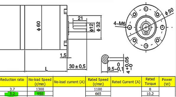

Aliexpress 12V motor
https://www.aliexpress.com/item/1005001644698564.html 5.2 :1 ratio 12V 950RPM

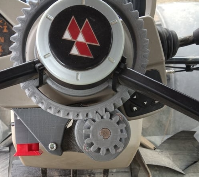

For some ideas on how to mount the motor to the wheel, check these resources out: https://discourse.agopengps.com/c/hardware/stl-file-links-and-bracket-ideas/39
PotatoFarmer has made an awesome 3D printed gearset and motor holder, check that out here: https://discourse.agopengps.com/t/universal-fit-gear-system-with-quick-tach-motor-holder/6579 STL for the MFA motors small gear: (don’t use PLA for it go with PETG or TPU) https://discourse.agopengps.com/t/universal-fit-gear-system-with-quick-tach-motor-holder/6579/269
