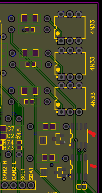

The PCB of Tony
CommonRail has an excellent resource including the code you need here on how to learn about CANBUS, and control your machine with it. CAN controllers on Tonys board as per:
CAN1
Tractor BUS / armrest when the Engage message (button) is one a different bus from the valve.
CAN2
ISOBUS (not really in use) we can put NMEA2000 position on the bus
CAN3
V-Bus or Valve Bus this is where we communicate with the valve. (Read the angle, send the desired angle)

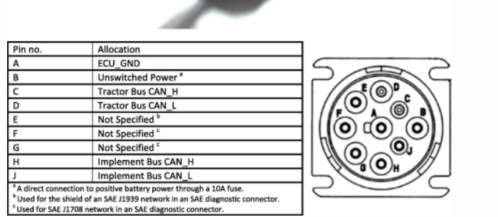

Generic CAN connector pinout:

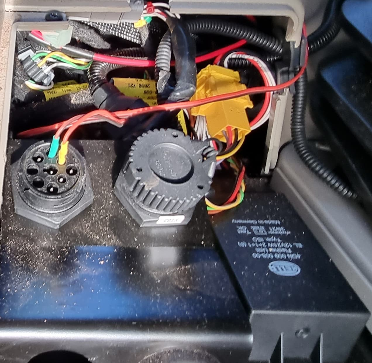

Massey Ferguson - steer bus location:
(There’s also a black DT 3P connector
with a CAN terminator on some models.)

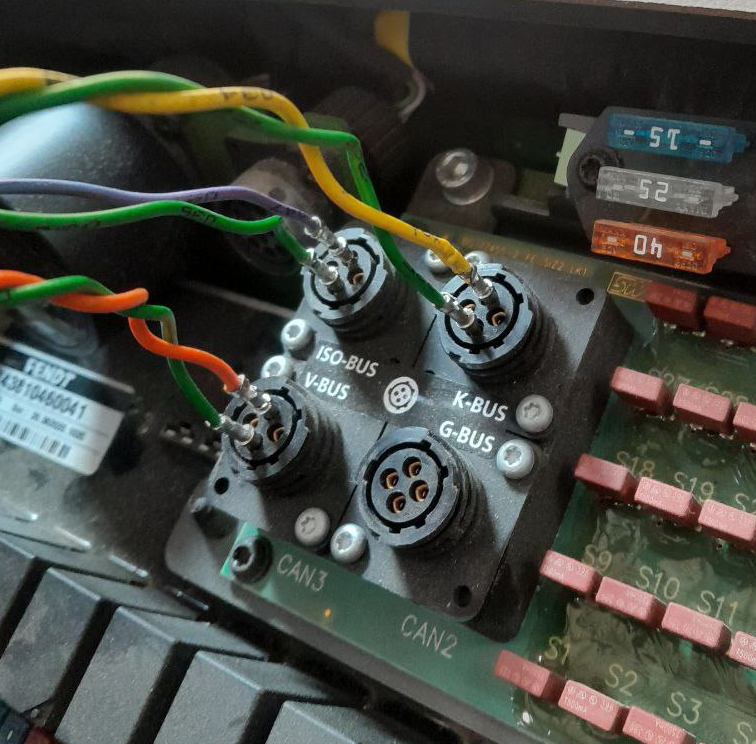

Fendt (V-Bus is for steering):
