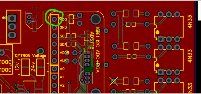

  • WAS -> 5V check for the WAS 5V rightmost visible pin on the ampseal from the back.

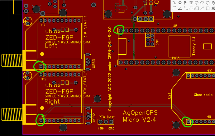

Micro: Check for 3.3V and 5V on the circled pins, compare them to a grounding point. (New boards will have LED-s to assist) Except teensy it should be 3.3V
ADS pin should be 5V as well
Standard:
Check for the following voltages:
  • 5V regulators for the GPS / Teensy / ADS / can
