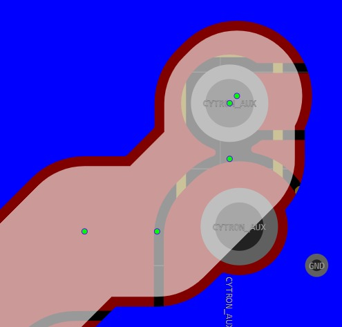

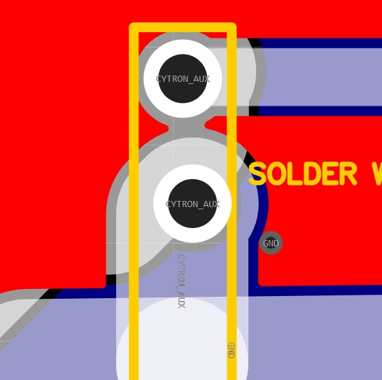

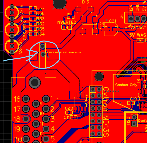

These fixed are for v4.1 STD / Standard only
v4.5 boards do NOT need these fixes!!
The trace next to the ampseal is touching the direct 12V input, so for 24V motors please cut the trace. For valves / 12V motor the outside 12V pin will power your cytron directly. (so the label is misleading)
