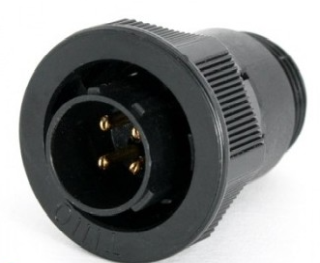

![]() | TT1110-P04 Fendt old-style ISOBUS/K-BUS etc connectors |

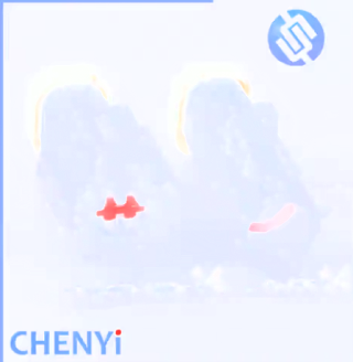

![]() | For Danfoss valve https://www.aliexpress.com/item/10000360045685.html |
![]() | For Case/NH WAS https://www.aliexpress.com/item/1005005231434626.html |

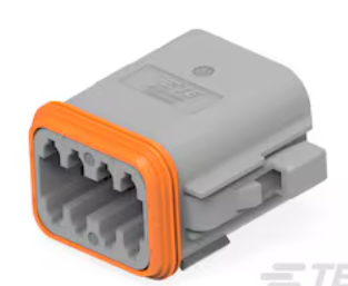

![]() | Part Number: Deutsch DT06-8S Typical usage: Keya Gen4 motor https://www.te.com/en/product-DT06-08SA.html Male pins (if required) are: https://www.te.com/en/product-0460-202-16141.html (1.6mm diameter) |

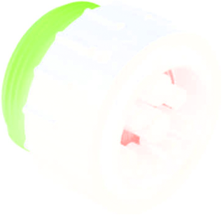

![]() | Part number: search “J1939 plug” Typical usage: ISOBUS/CANBUS connectors https://mou.sr/3ogaikK https://www.agritronixcorp.com/amphenol-tuchel-c016-7-terminal-plug-male-kit.html https://www.aliexpress.com/item/1005002988396207.html https://www.te.com/usa-en/product-HD16-9-1939S.html |
![]() | Part number: search “J1939 plug” Note, typically green plugs are for 500kbps sockets. Black for 250 or lower. There is a subtle pin difference to the above with regard to the diameter of the top pin. https://mou.sr/45feOk9 https://www.te.com/usa-en/product-HD16-9-1939S-P080.html |

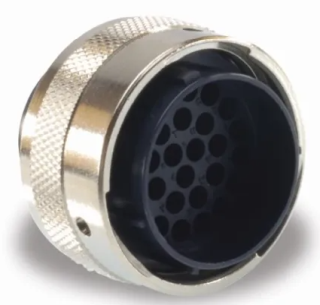

![]() | Deutz Fahr CANBUS Cannon Trident Ringlock Part Number TR1619PFS1NB https://www.digikey.co.uk/en/products/detail/itt-cannon-llc/TR1619PFS1NB/2487190 Pins are T2P16MC1LT https://www.aliexpress.com/item/1005006200968123.html https://www.aliexpress.com/item/1005004062210756.html |
